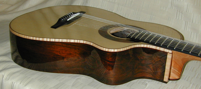

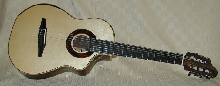

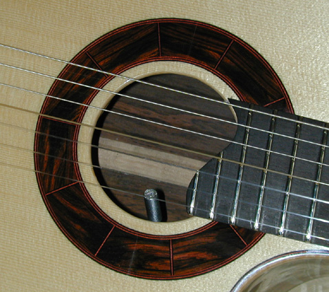

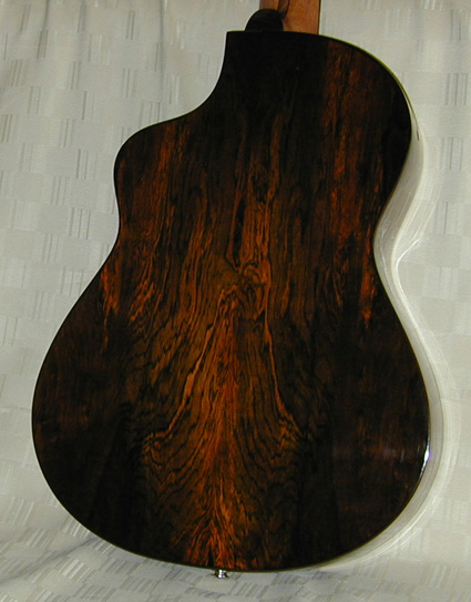

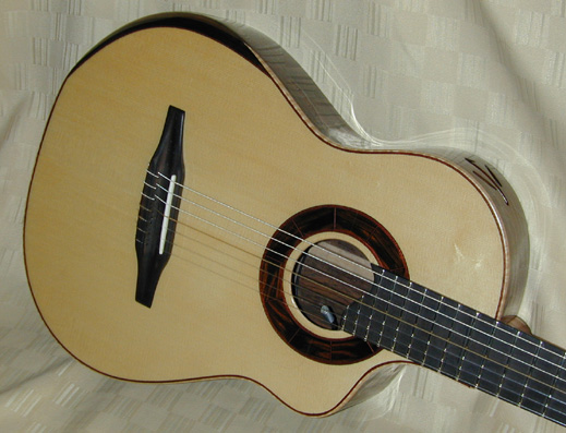

Here is a students guitar, just finished a couple weeks ago. Modifed classical shape, 5 fan bracing, slanted lower transverse bar, Hauser 2 brace sizings, no bridge plate. Back is braced in spanish cedar, top is sitka braced. Back and sides are braz rw, top is master grade euro spruce, bridge and headplate is braz, ebony board, Spanish cedar/walnut neck, walnut armrest, 3/4 per side individual Gilbert tuners, ebony dot and buttons Scales are 635 high A, 650mm low E. For a high A string, 40 lb fishing test is used ala Lenny Breau. SOunds pretty sweet, it also has a trinity classic K&K installed.

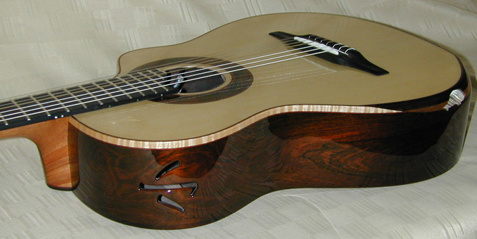

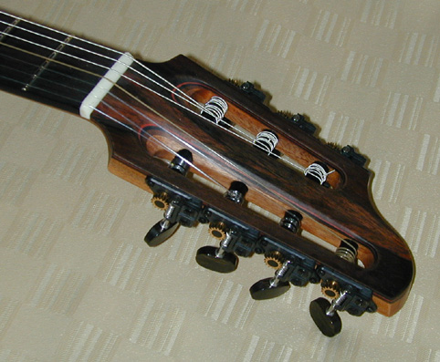

Here is the headstock, and the sideport he designed - chines symbol for humble !!! Finish is notro ont he body, and the neck is wipe on satin poly, hand rubbed.

That sure is a beautiful guitar!! Your student did a fine job! Is that fret markers at the 12th? I thought I was the only one that did that on classical!
What do you think of the hand wiped poly for the neck?

Actually not seen, but he did traditional markers down the fretboard side. The poly is very nice, I am trying a wipe on oil again to see whcih I prefer - I think the oil may look better, they feel about the same.

Thanks Tony. I've used a fair amount of the poly in my home building days on stairways. I like the stuff. I'm thinking I'll give it a try.
